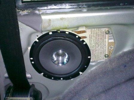

I'll grab a couple of snaps of the 17s in place before I put the panels back securely (I was just heading out to the garage to do it).
Yeah the later cars have space for 17s as standard as that space would have been used if you had the 10 speaker option. They sit just forward of the 4x6 which is why I wanted the 968/10 speaker panels so the had a better chance of being heard.
Hopefully a picture will make it clear.

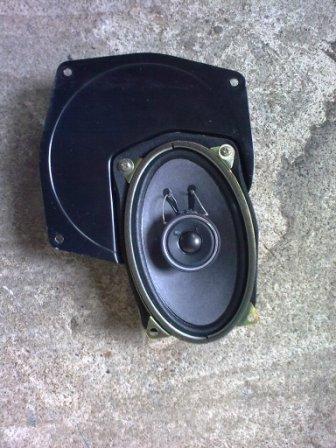

Okay, pics as requested. This is the old speaker and mount in there as standard.

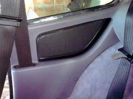

And this is how it looks with the 968/10 speaker panel fitted. There's a bit of white adhesive on the window rubber from a previous clumsy owner that I've now removed.
I found the best thing to ease the vinyl out from under the window seal and to replace it was a plastic bicycle tyre lever to hold the seal up and a cheap trim wedge I bought at a car fair to ease out/ease back in the vinyl. A wide screwdriver with its end wrapped in insulating tape to ensure it doesn't tear the vinyl would do the same job as a trim wedge.
So, that's all done without removing the windows.

You said that you covered the 6x4 holes in the rear. Where did you mount the 17s or do the newer cars have space for more speakers?
Later cars have more space, with a filler plate used to mount the old 6"x4".
That looks great. Well done!
Would look even better in a black interior. Hmm "¦
