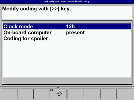

There is an option in the Instrument Cluster menu for Spoiler Coding......
Richard that stumped me.......

I quickly trawled through the workshop manual last night and couldn't find any details about the spoiler coding in the instrument cluster, which is strange. Why have the coding option, and no instructions? I had assumed that it was the same as OBC coding, in that you simple set it as 'with obc' or 'without obc', but it isn't. I'll have to delve a bit deeper. Interesting suggestion from Loren, but I can't understand why the PSM would only show the high level brake light, rather than all the brake lights.

If yours does the same, I think you have got it sorted. Sorry about my red herring with the cluster coding. I've got to look at that one again.......
