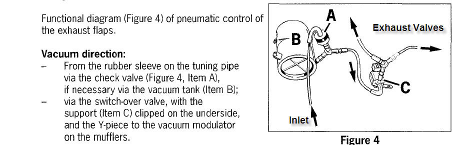

I see there is a post on the 997 forum about this, but I could do with a little help to identify what one poster there has said "I have seen the vacum valves getting stuck. Pull the vacum line with the T connector from the 90° angled nipple of the PSE valve and see what happens".
I have it booked in the OPC this week but it would be nice to know a little more before then. A diagram would help to find the items too (thanks Richard!!!)
I had it fitted in December 2007 so its out of warranty.
Here you go. I have marked it up where the tubes go. I would look for something simple like a disconnected tube, as if the valves aren't getting a vacuum the default position is open (loud). The valve and canister are mounted on the engine at the top right hand side, so fairly easy to spot.

The PSE works by providing a vacuum to pull the valves closed making the exhaust quiet. If you exhaust is no longer noisy it suggests one of three things.
1. The springs that return the baffles to open are weak or broken
2. The baffle in the exhaust has seized closed
3. The vacuum solenoid that operates the PSe has failed "open" providing a constant vacuum holding the PSE in closed position.
If you can get under the car or to the correct vacuum solenoid and disconnect the vac line this will prove item 3.
With the engine off , the vacuum slowly leaks away so the valves should default to loud. Put a mark across the end of the pivot pin with a felt tip and check to see if the valve is operating when you start the engine.

There is of course number 4 possibility to be added to your list and that is a broken actuating arm on the vacuum unit as was the case for me.
For the latest update - eg. replacement of the vacuum unit please see post number 16 >>>HERE<<<
