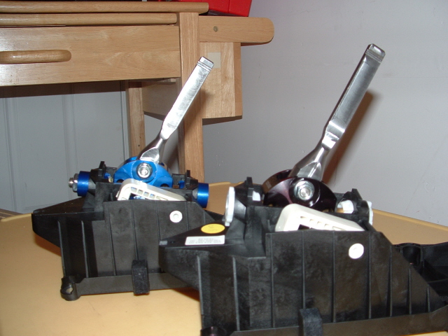

I've got the B&M fitted to my S (without the bean-can). Big improvement to shift feel - requires a much more positive shove to change gear. Also, the parts in the kit are of a better quality than fitted as standard. I found the standard shift is distinctly limp-wristed, so the B&M (or the Porsche version) was a must-have. Pretty straightforward to fit too. Go for it.
ORIGINAL: Mark Bennett
I understand the B&M and Porsche items are distinctly "similar"...
Nope. One is blue and the other is black.[:D] And one cost more than the other.

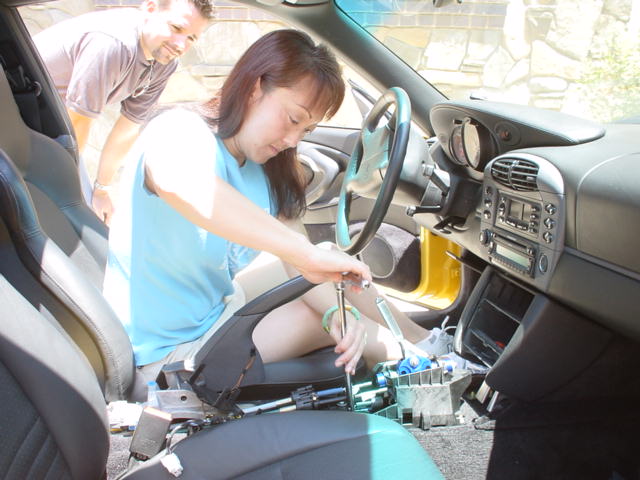

The only thing is the instructions do not tell you is to mark the location of the shift cables before you remove them.
We usually get Aileen to come over to our work on cars days when we are doing a short shift install. That way we can drink beer while she does all the work.
