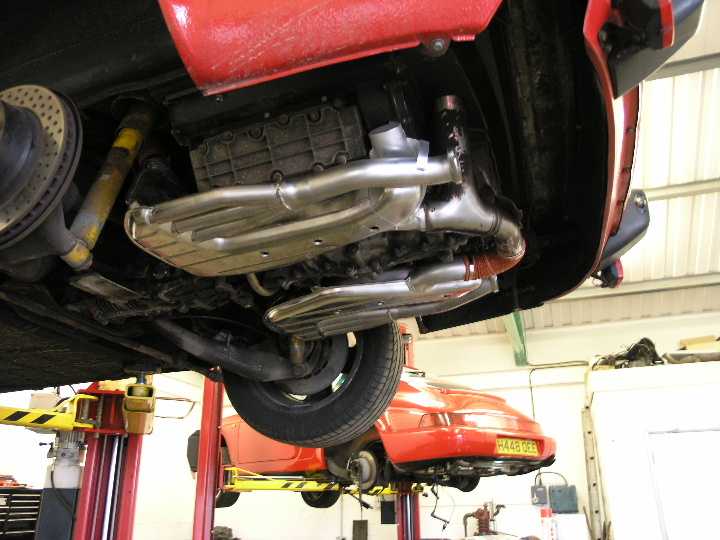

Watson Autoparts sell them for about the £850 mark for a set, you'll also need a new back box with twin inlets, I've used a Dansk Sport box and it sounds great. In addition, you also need to change one of the oil pipes.
With regards to the heating, we modded the manifods prior to fitment to retain the heating system, I'll try and dig a photo out of how its done. As Chris suggests, 9M do a kit with the mods already done.
SSI's are actually available in two pipe sizes, do a search on Pelican but from what I remember its the larger of the two that you need for a 3.2.
See attached image of the HE's fitted to the car. Having thought about it, if you don't mod te heating system, all you loose is the blown warm air and you can back date to the SC type heating with the air forced from the main cooling fan. You can pick up the required ducts from a breakers for very little, in addition you can then loose the big electric fan from the engine bay and save a few kilo's to boot!
