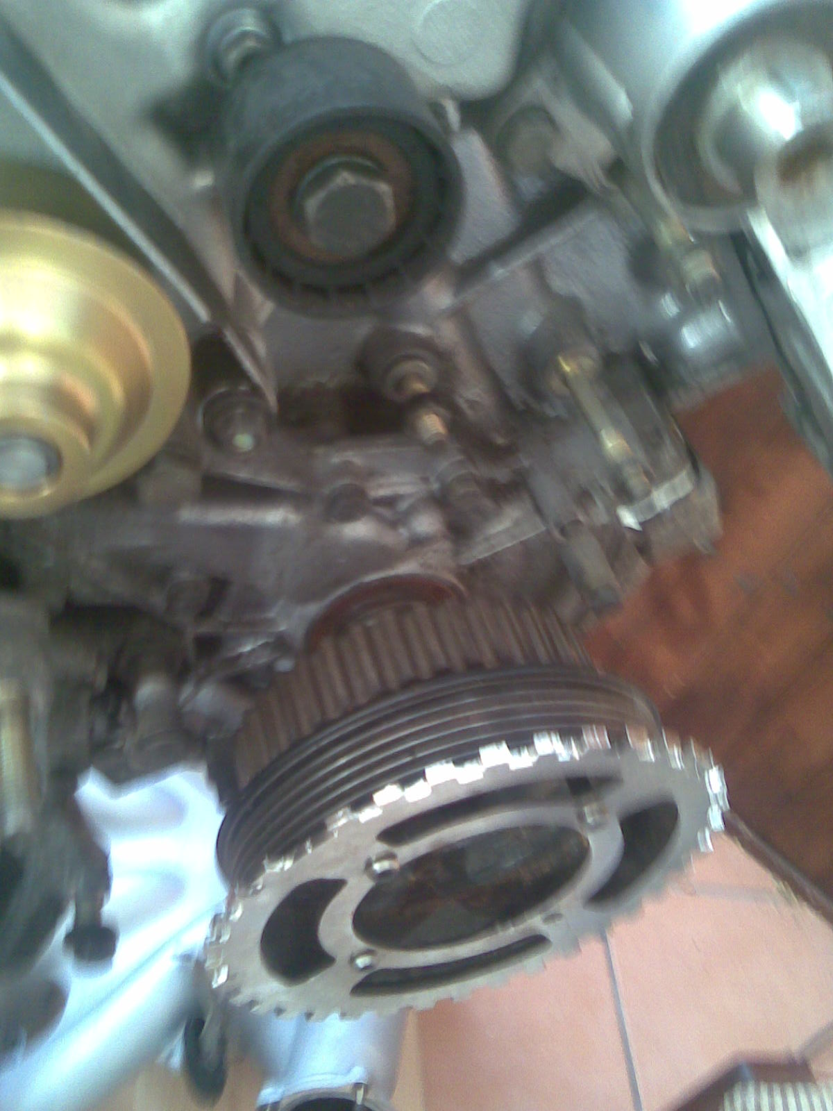

The biggest hurdle with standalone is the speed/ref sensors, they can be used as I have but I dont know about other ECU's.
This is a trigger wheel you can buy from trigger-wheels.com.
I decided not to use it as it means losing the power steering pulley. It is possible to fit the pulley with a washer but then the belt will run out of true and I can't see an easy way to move the pulley on the pump. Another solution but hard to do unless the engine is already out is fit a S2 flywheel as they have a more standalone friendly number of teeth, 60 rather than 130 on a lux or 132 on a turbo.
