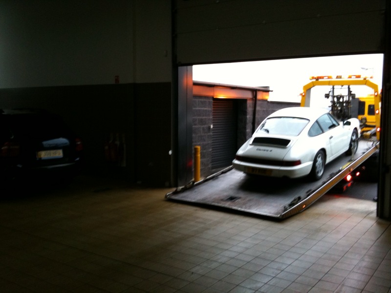

Our Starter motor failed yesterday without warning,waited ages to be rescued![:(]Does this happen alot?

New one ordered,arriving tommorow morning,should be up and running tommorow pm,Porsche center Leicester are great...![:)]
Was just suprised it died so sudden without any warning!
Nope they are fitting it,guy doing the job drives to work in a 964,He knows his way around one so hopefully won't take that long[:D]
