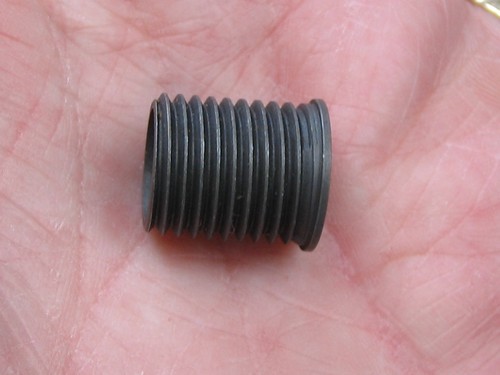

I doubt it was cross threaded. Probably just corroded, and it chews the thread when undoing the bolt. Very common.
What you need is a Time-Sert thread insert. They can be fitted in place, and are not too expensive once you have the tools.
Instructions are in my book. [;)]
Edit: Here's what they look like.

If we are talking Helicoil ? do it yourself, What size? I will send you one if you want?.
Regards.
I wouldn't use a Helicoil. They are fine for some repairs, but in an application where the bolt if removed periodically, the solid insert is a better bet. (You would also need a special drill and tap for the Helicoil).

I need a 12mm bolt.
Options.
1) time sert kit. Does the job and a quarter of the price.
2) second hand knuckle available at £80.
3) new knuckle at £450
Option one seems like the most viable for now.
