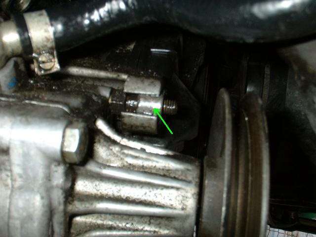

The problem.....
Is the part that the front thread goes through (green arrow) part of the casting? or an insert that needs to come out to get the pump off?
If its an insert, spacer or bush it is not shown in the parts catalogue and wont move!
Looks like part of the casting but difficult to tell, If it is the casting how can I get the pump off as when I slide the pump back the end of the thread is still in the hole?
Mike
Just noticed in PET that from 89 there was a sleeve fitted in the front.......more confussed than ever......do I get the big hammer out?
So, that is the bush that is stopping you removing the pump. Once the oil has had a chance to work, try and drift it out.
andy
Thanks lads,
Drift and bigger hammer did the job, it was solid.
Not a bad job when you get the pump free and then make a short spanner to fit the pressure sensor[:'(]
Cleaned that pesky bush and used copperslip on it.
I know have a working oil pressure gauge[:D]
and a bit more knowedge[8|]
Mike
