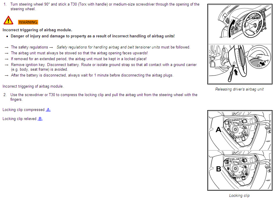

have had a look there are no screws at the back of the wheel,the only hole there is is in the side about 6mm no screw in there looks like a peg.thanks for help
Glyn is thinking about the 986 airbag, which is different.
Here are the instructions for releasing the airbag. It is fiddly to do first time, as there is a bit of a knack to it. The trick is to get the right size screw/torx driver to release the clip.
