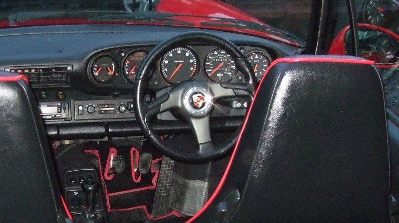

Hi Steve
this is the sterring wheel I have fitted. It fits the boss ok and onto the steering column ok.
Like i said it just doesnt disarm the indicators.
Therefore i think i'll check out the stalk adjustment to see if that has any effect.
Also to get the horn working i had to lift the copper strip so the adjustment might also allow me to lower the copper strip.
Any ideas about where the adjustment is or how to adjust it.
Cheers Steve i'll try this.
Lee, yes if you had to bend out the copper strip it means that the indicator assembly is too near the dash. Remove the plastic cowlings from the mechanism (about 4 screws) and you'll see how the mechanism is clamped to the steering column. Just loosen if off and pull towards you and re-tighten.
Just found a pic of the stalk assembly - you can see the clamp on the back which is used to adjust its position on the steering column.
