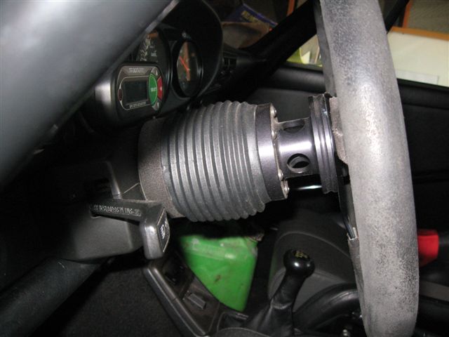

can you still get these for oe rs wheel? have been told it is different wheel you have to get???? anyone got one around the garage wasting space[:D]
Like this , if you use another wheel

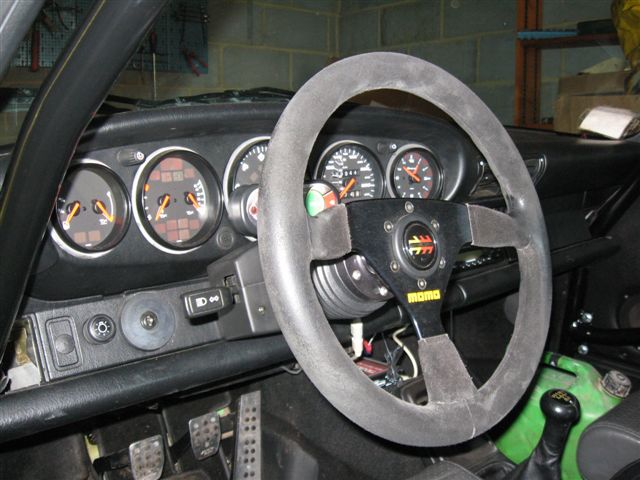

The spacer is made by omp and my wheel is a momo. There are two options depending on how far out you want the wheel to go. Flat wheel or dished. You could just fit a dished wheel. One thing to note is that the turn signal stalks are further away once the spacer is fitted. Doesn't seem to cause a problem but is more fiddly. Think you might spend a long time trying to find one for original wheel.If one exists ?
Should also mention , you will need the momo or omp hub as well. The spacer goes between the hub and the wheel..

i have gt2 cup seude wheel with extension on at moment,just find it bit small with 18 wheels
