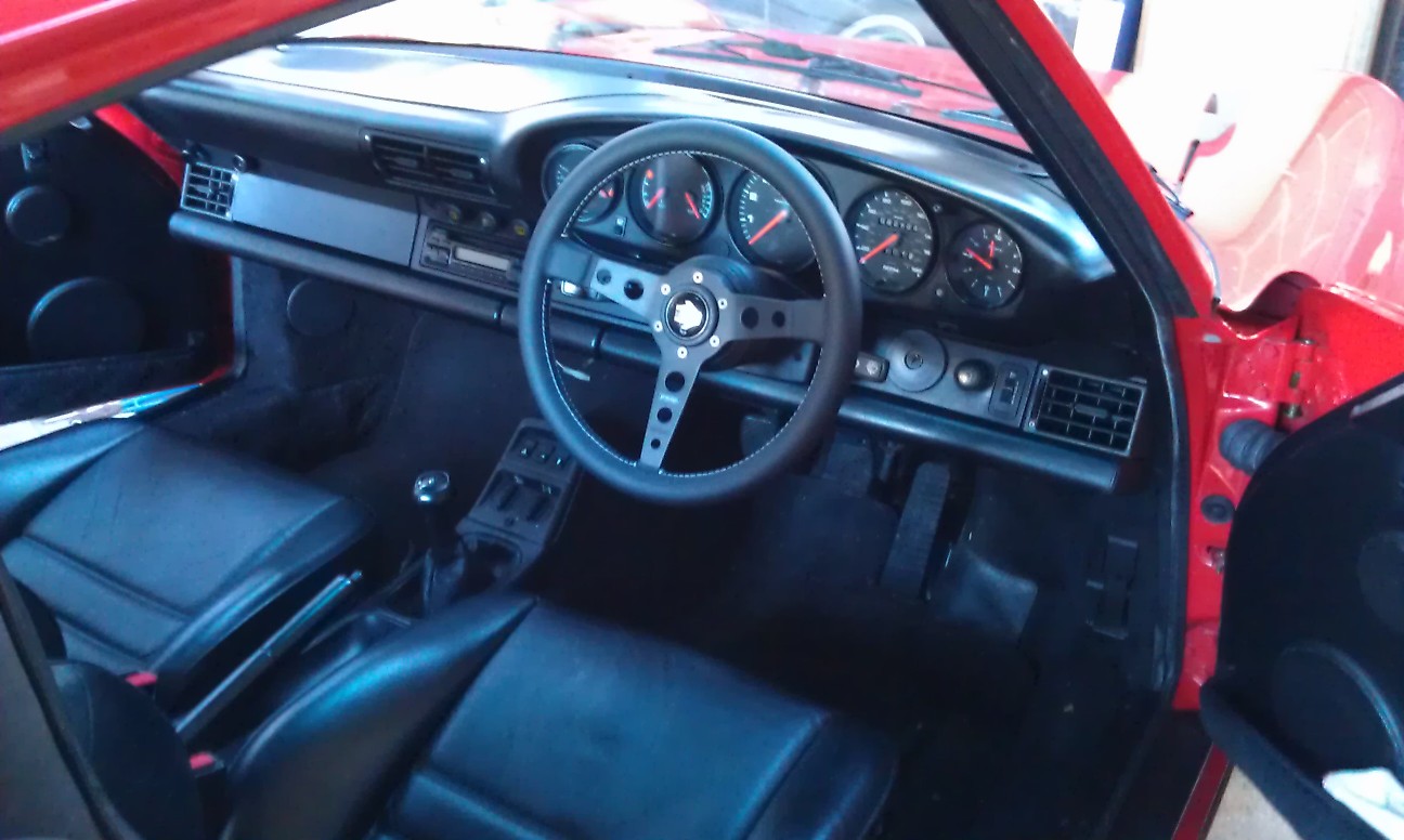

Thought you might like a picture of the new wheel.
ORIGINAL: Gimme Shelter
That is what a C2 wheel (before the airbag era) should have looked like. I never understood the ugly original wheels.
Looks good!
