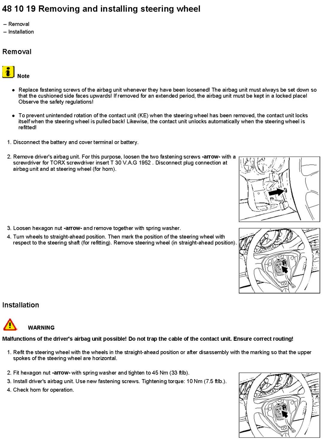

Are there any pitfalls for removal of steering wheel on a 996 turbo just want to take off and have it smartened up a bit just worried about the airbag etc.
Disconnect battery and leave for 20 minutes, then size 20 torq bolt from behind, 2 minute job
As Matthew says, and don't reconnect the battery until the wheel and airbag are back on.
