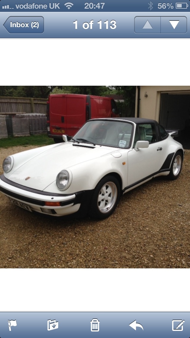

I've recently become the proud owner of a 1989 Targa SSE and whilst she is in lovely condition I would like to make a couple of sympathetic changes and would welcome your thoughts and advice on the points below:-
1. She has an old Panasonic tape deck stereo in and not the original Blaupunkt Toronto. Whilst I love the sound of the flat 6, I would like to listen to music and news in traffic occasionally so would like to change this and wondered what was generally considered an acceptable modern replacement?
2. The central locking, alarm and immobiliser all work perfectly but I have no remote fob for the system. From my research it seems that this may be correct and that in '89 the system was indeed key operated. Can anyone confirm that please? Secondly, has anyone added remote operation without removing or altering the original system?
As a newbie I'm sure I will have plenty more stupid questions but your advice will always be welcomed.
Many thanks.
Jason
PS. Here is a pic. 37,600 miles, limited slip diff and short shift box all factory options. Hope you like.
Welcome Jason!! Lovely looking car.
