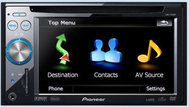

I've just bought a Pioneer AVIC F900BT 2-din system for mine - another project for the Christmas holidays. Bluetooth, Nav, DVD, iPod, camera database, and more, all in one:
wow that looks a nice bit of kit ! - i have to ask santa to bring one perhaps !! [:D] is it touch screen , that looks to be way forward now . enjoy your new toy ! regards
That does indeed look impressive.....Will it be plug and play? ...can you get adaptors for the wiring harness or do the plugs just fit straight in?.....What are your thought regadding the trim fitting?
Chris - Yes, it is touchscreen. I miss the one I had in my C2 so much, I decided to fit one to the Turbo.

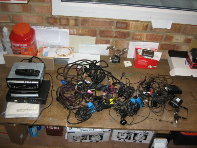

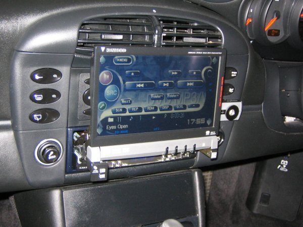

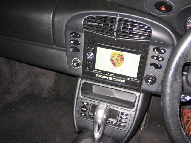

What a struggle that was! It took me all Boxing Day, and half of Saturday. Most of Friday was taken up removing all the Kenwood wiring, the Sony Ericsson bluetooth kit, and my Origin b2 camera detector. Then I had to convert all the wiring back to standard DIN connectors, as they had been cut to pieces by the "professionals". It was a real dog's breakfast before I started, and I am really pleased to have got rid of all the rubbish and tidy up the wiring loom.
Before (without the Origin b2)​
This is what I removed​
The new installation​
It's taken me quite a while to configure it, install the camera database, update the software and generally set it up how I wanted, but it's been well worth the effort. It looks great, sounds great, and has tidied up the dash no end. So far, I'm a very happy bunny.

The trim came from http://stores.ebay.co.uk/Euromotorspeed. In fact, I bought the complete fitting kit, which was a waste of time, because I didn't use most of it.
The cubby came from Porsche, part number 996.552.253.01.01C. £20.42, less discount, plus VAT.
Since fitting the unit, I've been doing a lot of tinkering with it. In fact, the operating system is Windows CE, and you can boot it to Windows. It's really handy for changing some of the things you don't have access to with the normal interface. For example, the speed camera warning sound was a barking dog! Also, I couldn't transfer my phone contacts in one go (had to transfer them individually, due to a limitation on my phone). There is a db file on the AVIC that I can copy to the SD card, edit on my PC, and transfer back to the AVIC. So far, I'm really impressed.
