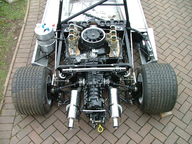

The rear of the car is all painted black since the wife allowed a pass-out to the garage for the weekend, so got lots done.
I have a neat pile of tubes all ready for the nickel platers, and a very long shopping list for gaskets etc so I can finish off the underside of the engine. With a clutch and a repaint of the box it can go into the car for good (well, for 2009 anyway)
I love this stage of a project when all the hours start to come together.
It is important to have 'achievment' points on a long haul job like this.
I think over the next 2 months it will move a long way forwards.(it needs to)

Lots os bits arrived this week. The Smart Racing stuff is on (and looks sexy), the headers are all wrapped, and look neat, the fan is all back on and looks cool.
Best order the clutch pdq!
It's in there somewhere........[:-]
