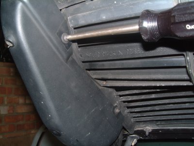

Happened to mine. It was the little micro-switch sticking in the spoiler, and bet yours is the same.
If you look under the spoiler on the left hand side, there is a semi-circular plastic cover held on by 2 or 3 screws. If you take that cover off, you'll see that there are two little switches that stop the spoiler at each end of its travel. On mine, the rear most one had stuck in, which stopped the spoiler lowering, as on yours. I just sprayed a little wd40 on it, and pressed it in and out a few times, and since that it works perfectly. With luck yours is the same simple fix?

Well it took me a couple of days to get around to it in the end, but you were spot on - this was exactly the problem - thanks for the tip [:)]
Pete
Hi - to add more clarity, the Semi Circular plastic cover referred to is this item:

I'm really pleased that it was the same simple problem on your car! When mine went, I thought oh... here we go... new spoiler gear, or repair and several hundred pounds coming, but a little bit of exploration and it was fixed in seconds, which was very satisfying. Thanks for posting photo, as it does make it clearer which semi-circular (sort of) bit of plastic I was talking about.
