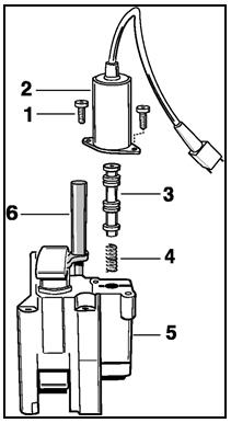

Thanks for that Richard: so 5 is the valve is it? And 2 the coil? That would account for the difference in the cost of the job. Replacing 5 is a cams out job I guess?
Yes, 5 is the valve, and 2 is the coil. The cams don't have to come out, but the covers have to be removed, and there are special tools to hold the cams in place.
