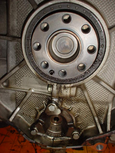

Seen it happen before.
In the bottom of the pic you see the intermediate shaft flange, held in place with 3 bolts. See the hole in the middle of the flange? Sticking out of that hole should be the threaded end of the shaft, with a nut on the end. The threaded end had sheared off the shaft, so you do not see the shaft or nut as it has fallen away.
You are left with one big hole for oil to pour out of.
