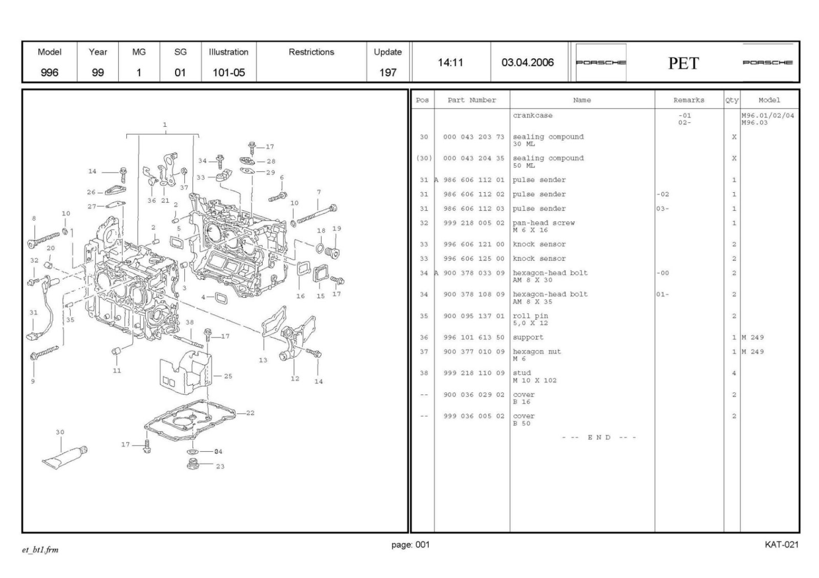

Can anyone tell me the correct sump sealant spec???? this is necessary following an impact dropping of a kerb and clipping the underside of the engine sump causing a hair line fracture. The sump has been repaired today so the sealant spec is needed. When removed there was no gasket, only a clearish silicone.

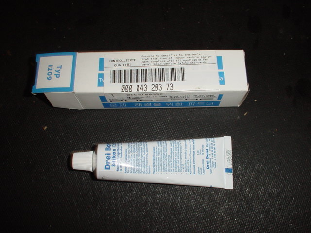

Porsche Part Number is: 000 043 203 73
Have in the meantime contacted loctite who have recomended 5699 grey. Have two options now, thank you .
Have just spoken with AFN guildford v helpful the part no' has been changed to 204 35 in stock for approx £10.00 inc vat
I watched a sump replacement 6 months ago and the mechanic used this. Just a silicon. I forget exactly what he told me. They may had used something else in the past, or the tube of silicon is also used on windshields
