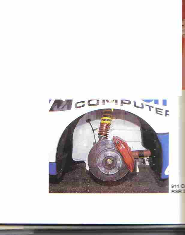

Here is a picture or the 3.8 RSR suspension.

Dual springs have a lighter initial spring rate which provides for a smooth, supple ride oversmall surface irregularities. Then, at a detrmined point in the suspension travel, the stiffer spring takes over. Spring rates are very simple. They are measured and it is a simple fact that a lighter spring rate leads to more body roll and therefore if a dual spring suspension set up has an initial spring rate lower than standard, the car will, initially, roll more than a standard car. What complicates matters is the ability to adjust damping and in particular, low speed damping.
Bottom line is, having now amde the enquiries, I am totally convinced that initial body roll with the KW set up is more than with standard springs. However, total body roll may be the same or even less. However, the initial extra body roll will effect the turn in characteristics. I fail to see how this can lead to faster times on the track.
