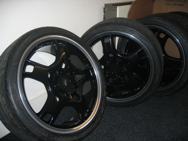

Am having a spare set of wheels repainted in black, and considering winter tyres on them.
Anyway, I know lots of you get your own wheels on/off at home and I wanted to learn your tips. What do I need to buy and what do you recommend ? Low-nose trolley jack, wheel brace, wheel alignment prongs, special 19mm nut tool, anti-seize paste, torque wrench and so on ???

Your list of parts is spot on - for occassional use don't get carried away buying the very best jacks and torque wrenches - you can spend a small fortune, just buy something thats more than capable.
Rob, as previous post says your list of parts about covers it. However, I use the standard Porsche scissor jack (996 721 211 00 price €135) which obviously has the correct interface with the jacking point but I always back this up with a strategically placed axle stand. I also use the soft socket (9 605 6543 price €25.1)which has a nylon cover that provides some protection for the wheel, it's also a lot easier if you use two of the threaded bolts (999 571 074 30 €5.43) although Porsche only consider it necessary to have two when PCCB are fitted. The prices are exc VAT and are what I paid when I picked up these parts in Germany in 2006). The recommended wheel bolt grease is Optimoly TA but my OPC doesn't stock this so I ordered this from http://www.motobins.co.uk/search.php current price is £6.75 + VAT + postage. Oh yes - almost forgot - the torque wrench, I bought the Draper 3001A which came out top in the Auto Express comparison http://www.autoexpress.co.uk/products/products/59647/torque_wrenches.html

You can use your torque wrench but I tend to use a normal long-handled socket wrench for removal and restrict the use of the torque wrench for fastening. I wouldn't recommend trying to remove or fit wheels without the threaded bolts and as these are cheap I'd get two, the rear wheels are quite heavy and having two makes alignment that much easier. The soft socket is not essential (and is not in the tool box) but it does offer some protection to the alloys but not the bolts -it's basically a long socket with an outer covering of nylon. The numbers are the Porsche part numbers, I'm reasonably sure they are correct but check the item descriptions with your OPC I wouldn't want to be responsible for you inadvertantly ordering a GT2.

19mm is the distance across the flats of the wheel bolts so I think the special 19mm (not inch) nut tool is just another term for the soft socket; BTW this is a metal socket it's just sheathed in nylon. Sorry but I can't help re the best way of sourcing these parts you'll just have to ring and google. I've heard of potential problems with corroded threads so don't forget the Optimoly, but take care not to get any grease on the domed wheel/bolt interface; see the handbook for full instructions.
