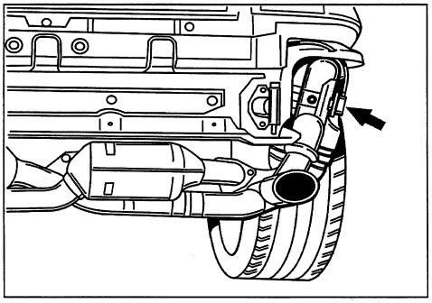

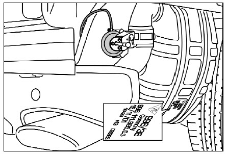

Depends on whether you have the original "Mk1" PSE or the later "Mk2".
Mk1:
