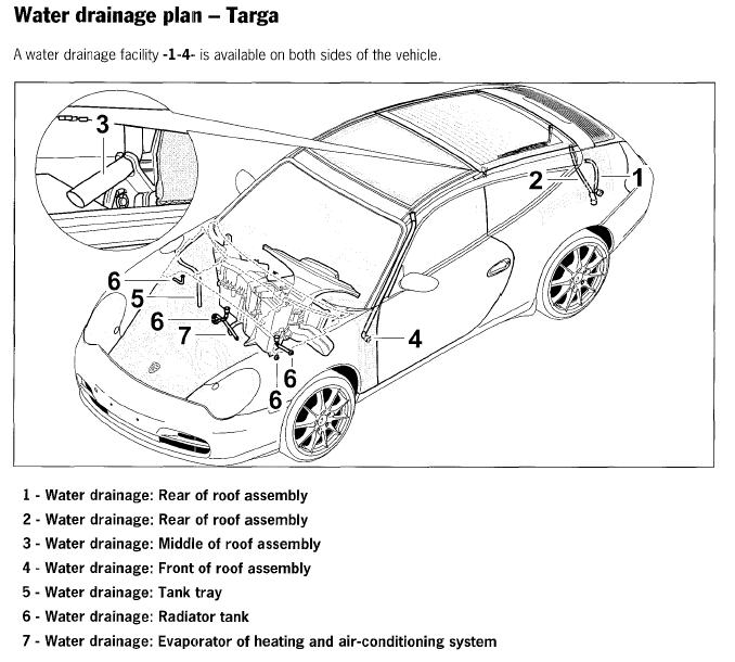

I've got a 2002 Targa and with this wonderful weather we've been having, I've started to get very small amounts of water ingress through the roof. It's hard to see exactly where it's coming in and it's only a minimal amount but I'd like to get it sorted. So 2 questions:
1. Is there a typical spot where these roofs are vulnerable (it only happens in downpours when the car is back on to the wind/storm)?
2. Is there a drain tube (like on sunroofs) that may be blocked causing the leak?
I can't help with 1, but the drainage plan for the Targa looks like this:

is there a more detailed view or photos of the roof drainage and access to them ?
i cant even see them !
especially #s 1/2/3
thanks
especially #s 1/2/3
thanks
They usually get blocked at the bottom end of the drain tube. I think on the Targa they come out of the wheel arch, but you might have to take off the liner to see them. Sorry, I don't have any pics.
thanks - guess ill have to take it to the dealer
abbas - i can see the picture richard posted - what i meant was i cant see the drain holes
on my car !
