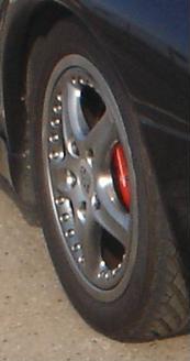

I had my Targa wheels refurbished by BJV Engineering (http://www.wheelrefurbishing.com/) around 4 years ago - cost me about £240 for 4 including all new stainless bolts. I had them refinished in Black Chrome(?), hopefully attached is low res image to give you an idea, sorry nothing more high def available
