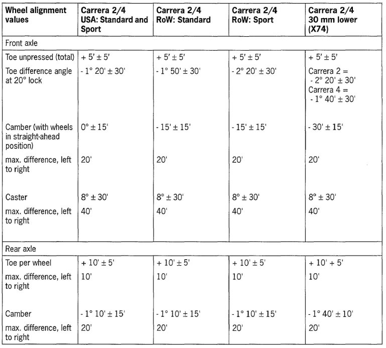

Joe
Soon after I got the car I had a full wheel alignment, after having a new set of tyres fitted. My independent found that there was too much negative camber on the rear, which had caused the tryes to wear out on the inner edges. Since putting it right, I have done 12000 miles, and the tyres have all worn perfectly evenly. I would be worried that Tech9 are going to put on more negative than is correct, just to make it look better. Having said that, they have had some good feedback on this forum, so would seem to be reputable even if they are a bit expensive.
The correct rear camber for C2's and C4's is -1° 10' +/- 15'. Unless you have a camber gauge it would be difficult to check accurately, but a plumb bob, careful measurement, and some simple trigonometry might give you a good approximation.

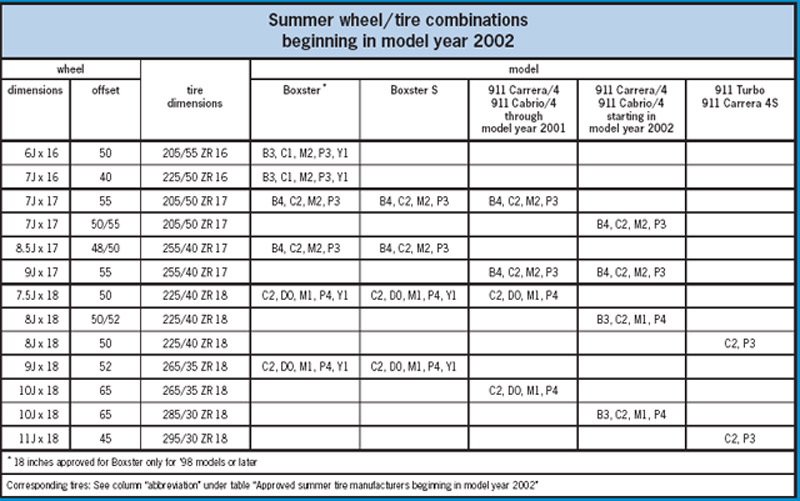

Here is the info on the factory wheel offsets
If you comapre the 17" wheel option of the earlier cars (255 rear tyre ET55) to that of MY02 onwards with 18" wheels (265 or 285mm rear with ET65) then it is clear that on the later cars with bigger rear tyres there is a need to move the tyre inboard to avoid rubbing the wheel arch edge).
You don't say what size tyres, but given the 11" rear rim width i'd assume 275mm minimum, in which case i'm now not surprised. Your ET of 52 means the rim is 13mm more outboard than the factory 18" option (and not dissimilar to the 10mm discrepancy you quoted originally).
I'm no expert in geometry, but i'd say you'd need some serious camber to get the tyre edge safely within the arches.
