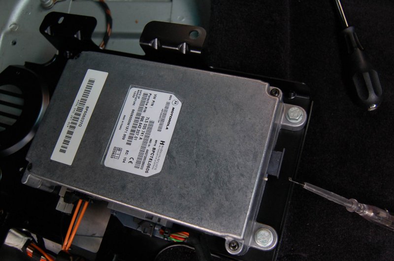

Look under the driver's seat (RHD car). If there is a silver box in a black frame bolted to the floor, then you have the phone module. If not, you haven't.

Have found a box under the drivers seat so it looks like im connected, will try an O2 sim tommorow.
steve
No silver box so no phone module.
