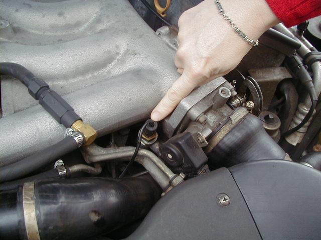

Just got to find out why the water does not circulate around the turbo when I switch the ignition off for 30 seconds or so like it does on my neighbours Turbo.
Any thoughts here would be helpful.
From memory there is a seperate switch for the auxilliary water pump on Turbos, it shold be listed on the fuse box card.
The switch itself is by the manifold (pictured) mine wobbles a lot but still works
If your pump isn't working them make sure you let the engine idle a little bit before you switch off, so that the Turbo has a chance to cool down properly, especially ater a spirited blast [;)]
Thanks Paul.
Yes my plug bit on the manifold is a bit wobbly aswell.

Jules,
Obviously the squealing is not good and probably points to the electric pump starting to wear out. If its still working ok you should see a plume of water in the coolant tank while its running. You could wait for it to fail totally and then get it replaced or have someone look at it now (maybe it's repairable, or a bearing needs lubing/ adjusting)
If it does fail you can still drive the car for a while observing the idling rule, but in the long, long term it will help your turbocharger wear out quicker. That pump was introduced because of early failures on the 924 Turbo and it's one of the reasons our cars can go on for a long time
The water pump should run when the engine is switched off, even if the 'wobbly sensor' is faulty, I think this is controlled by one of the relays, and will cause the pump to run whenever you switch off the ignition. My sensor was very wobbly and didn't work, I compressed the metal to stop it wobbling, it worked once. I now have a new 'non-wobbly' sensor.
The 'wobbly sensor' is a temperature switch which switches the turbo pump on should the coolant in the turbo reach 115 degrees. It basically shorts to ground so for test purposes you can make the pump work by disconnecting the lead from the sensor and connecting it to ground. Testing the sensor is more tricky, I set mine up to flash an LED when it is working - (not often in normal use) I guess removing it and setting up a simple circuit with some hot liquid and a thermometer.
Or buy a new one to be safe around £30 IIRC
