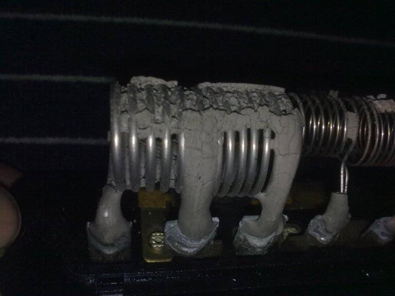

It is usually the resistor pack thats at fault with these symptoms . Is the replacement unit new or second hand ? If used was it definitely working on the previous car ? They can be quite easily cleaned to remove any oxidisation if necessary . Might be worth cleaning the connector if you haven't already done that as well . Here's a picture of mine before i cleaned it up .
