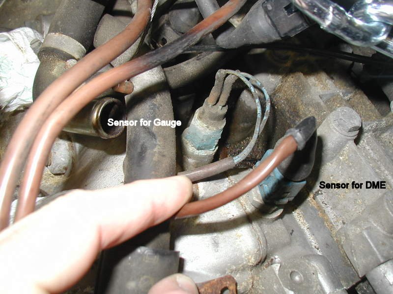

This is the set up I've got . . . apologies in advance as I can't remember where I borrowed the photo from.
Clarke's gives a test proceedure for the gauge (if you have a handy potentiometer) but does -not- explain how the sensor works.
As a shot in the dark, if the sensor is a dual sensor, you would check the term inlays by earthing them to the body of the sensor itself.
