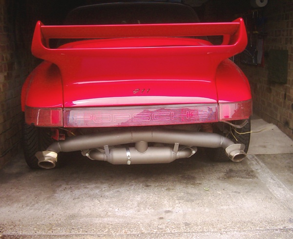

This is my Triad exhaust with early equal length headers (HEs) .
Hi Bones,
I'm sure you've said before but...
Where did you get your rear box from, I can't find it listed anywhere in the UK also what sort of cost was it.
Dan I bought it from the U.S they are not available here and are built to order, at the time they only made 2 in 2 out units but may have a one in two in one out now. The price including shipping and taxes came to £263.00 but somehow it slipped through customs without additional costs being added. I think Dave marked it as a low priced item. All units are mild steel and not polished but the welding is superb and the fit and finish excellent, (at least on my unit)
The website is www.triadwestperformance.com but I noticed that the site is down. You could try emailing Dave at
Newtriadwest@aol.com
Search Pelican for info from other Triad West users.
