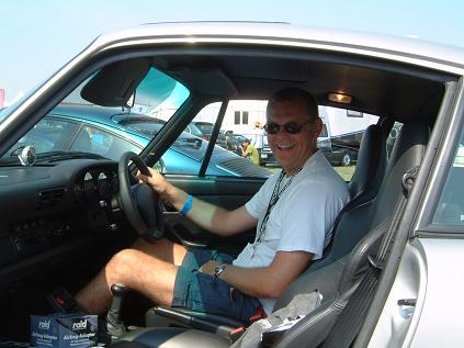

I looked at the Techart s/wheel which is v nice[:)], but then discovered that the Aitwe wheel is same as - they are sold through Raid Motorsport in Germany. This is a slight detour on the way to Nurburgring[8|].
I bought one and fitted it in the car park at the ring!!![;)]
It is brill[8D]
Have a look at this link http://www.raid-rdi.com and piccy attached!
Try again[8|]
Yep, it was/is an air-bag steering wheel.
1. Turn-off the alarm with the key (avoid the volt drop sensor)
2. Disconnect the battery.
3. Go for a stroll and watch the cars for an hour or so.[8D]
4. Remove the 2 torx screws from the back of the steering wheel that hold airbag.
5. Lift out airbag - BIG deep breath - pull off the yellow plug off the back - exhale![:eek:]
6.Centre steering wheel & remove 24mm nut and rock wheel to remove from splines.
7. Reassemble with new wheel reconnecting hole push button and airbag.
8. Grip new wheel with a big smile on your face - justifying the expenditure![:)]
9. Re-connect battery and reset radio, clock and alarm.
10. Go for a quick spin around the track! Fully justified.[:)][:)][:)]
Task took about 20 mins plus 60 mins wait - easy.
Cost - €500 in notes direct from the factory - Bargain
Is that enough info?
