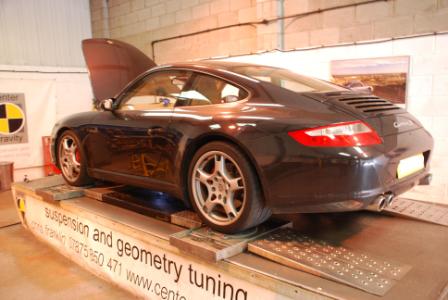

 Set Up
 Following the April Drive and Dine, I have a much better handle on the changes Chris has made to the car set up, frankly its transformed the cars on road manners - turn in is much sharper without having to have 2 bites on tight corners, as I sometimes used to have to do. The rear is much more planted and stable. The cars overall behavior is much more predictable - the car now breaths more with the bumps in the road (compliance) so there is a bit more up and down but it no longer kicks the tail to one side or the other with a big bump. The only minor negatives are a slight increase in road noise due to more rear tyre in contact with he road and a slightly lighter steering which means it hunts cambers on the road a tiny bit more, Overall a more than acceptable compromise for the benefits gained.
 The changes have given me much more confidence to press on and much better turn in plus stability - so the work was worth every penny. I can highly recommend Chris' work.

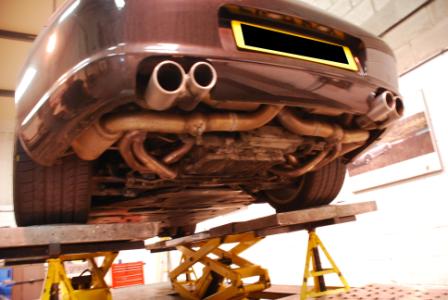

 The canning the car got from Chris and I on its set up run and on the drive and dine has really brought the sound out of the exhaust now - its making a very nice growl
 A couple of learning points here though - firstly the power curves in the Porsche gumph are it turns out from an engine on a dyno. They do the same to get power and torque figures. So not when connected to the rest of the oily bits, exhaust, filters etc. This then changes the actual power/torque curves you get on your car. Talking to my independent, all manufacturers do this - which is why my description of the basic curve does not fully reflect the near perfect graph in the sales gumph. Lesson 1 learned
 Lesson 2, having got a nice loud exhaust - its loud, once it cuts past 3k revs its a fairly noticeable noise in the cabin. Fine when pressing on but a little monotonous on the motorway at constant speed. Conveniently this equates to low - middle 70's. So for commuting this will now encourage me to stick it on cruise control at 70 on the motorway where the car is nice and quiet.
 Lesson 3 - manufactures quoted "power increases". i was a little cynical about how much difference some of the changes would make - if you added all the values up it was suggesting another 40-60hp. Which I was a little wary of. This is where Porscheshop earned there stripes because they were much more conservative and focused on the improved drive ability you'd get and the faster on road progress (plus better noise from the exhaust) rather than going for top end power figures.
