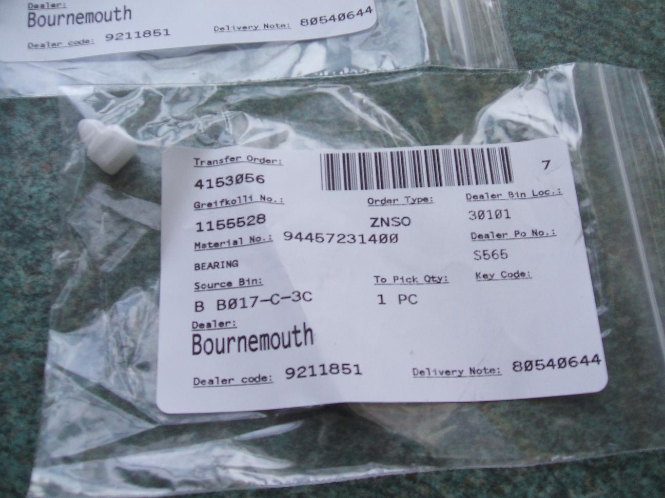

ok... following the Clarks Garage Guide, I have ordered both parts from Porsche Centre Bournemouth...
There was no metal clip on mine, so I am guessing it went AWOL when the plastic bit broke.
Knowing the plastic bit is cheap I was expecting a horendous bill for the metal clip...
Anyway... todays prices are:
944.572.314.00 - "bearing" - a white plastic clippy thing - ÂŁ0.37
944.572.217.00 - can't remember the official title, but a metal clip - ÂŁ0.24
All plus VAT, and I forgot to ask for club discount...I think I can live with it.
