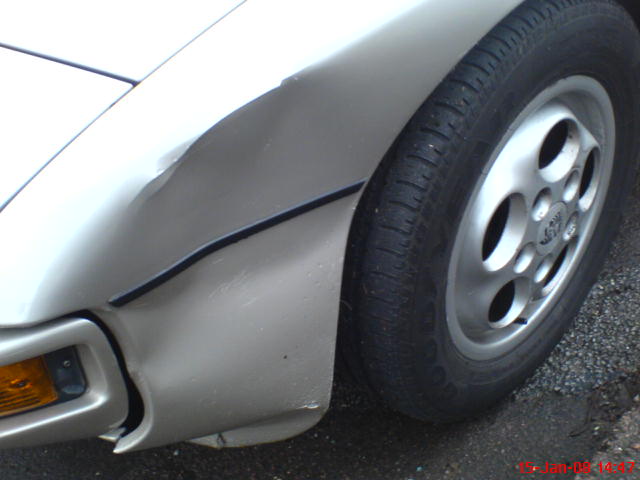

Shad...Read My previous Post....
My Passsenger wing was Crunched...(in Jan08) And the the insurance wanted to write it off....
I'm still looking for a decent wing...at least you have my empathy...
True. The OEM parts could well surpass the value of the car. Breakers/local body shop would be the way I'd go then supply the quote to your insurance.

cococola is right, the price of dealer parts are likely to write the car off after fitting and painting and don't go for spurious parts cos they're awful quality. You can buy it back off the insurance company for 'scrap value' which was £25 for my Mk1 Golf, i can't seriously see it taking you more than a few days to get another wing off ebay but the bumper could take longer. Loads of scrappers list cars they are breaking for parts but focus more on part condition (rust free) and put colour second. When it comes to painting make sure it's done by someone who knows how to do the job properly, preparation is 95% of the job and if corners are cut here the arch lip will be bubbling in a years time. If it were me i'd view the wing before purchasing. There are many different types of paint and you need to be aware that with 2 ages of paint on the car they're going to fade at different rates, the best way to counteract this is unfortunately beyond me. Hartech is a reputable independant porsche specialist end they are based in Lancashire. good hunting.
Thats stupid, looking at that pic of the damage, I think it would panel beat out. No need to replace. Modern bodyshops seem to have no skill these days.
