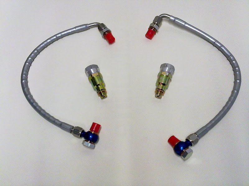

Here is a pic of the turbo oil feed pipes with the non return valves as fitted to the 996tt.
I have not had time to fit them as yet, but will post some pics when they are fitted before I refit the rear silencers and bumper.
