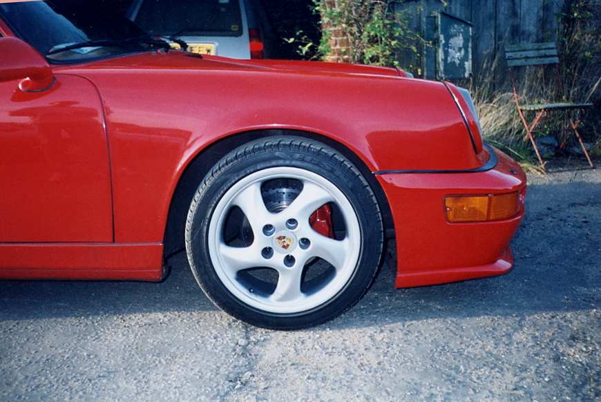

Make your own mind up about items you want for your car Richard no one will criticise you for painting you calipers red...... and here are mine all red and shiny.......as to brake fluid I rebuilt my calipers , fitted stainless steel hoses and drilled disks and the brakes feel better than I remeber with very few miles on the car. I use ATE 'blue' fluid. expensive but apperently one of the best available.
Bones, I think the calipers look great on your car - especially as the car is Guards Red. I may have to do a quick photoshop job on my car and see what the red calipers will look next to dark green bodywork. Do you have problems keeping them clean - and did you get them powder-coated or hand paint them with the two-pack kit?

Thanks Richard , it probably does depend upon what colour the car is I considered balck and yellow too as alternatives. The SC stoppers are well up to the job in my opinion, especially if your car is lighter than stock like mine. The biggest improvement I made to them was rpairing them with caliper kits, with the stainless hoses and ATE fluid Powermarques they feel very capable of stopping the car really hard. Stencil kits are available for the small calipers too, I laquered mine with a product Ibought from Type911
As far as cleaning is concernrd I have quite large gaps between the spokes so the calipers are more accessible than Fuchs for cleaning. I clean them once a week or more when I'm using the car a lot and they shine up like they've been newly painted.
