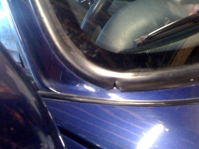

The 993's habit of collecting water in the windscreen aperture and eventually rusting there is a well-documented problem and will affect all of them eventually, I suppose. I've just bitten the bullet and had the rust bubbles around my front and rear screens sorted out. If you are squeamish then don't look "" the pics aren't nice.
Three corners of the two screens each had a small patch of bubbling paintwork "" about 6cm long and 2cm wide "" which didn't look really bad. However, here is what the bodyshop found when they took out the front and rear screens. Ouch.
