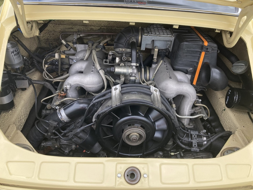

Ever since I had it installed and wired up (by Bob Watson) the throttle action has been irritating, but, only taking the engine from 800 tick over to 'just' getting going.
If i really squeeze the throttle pedal super carefully the engine will come off tickover and rev as you would want, but if you drive the car normally on the road there is this sudden jerk and all is then well.
I feel this is when the throttle lever on the engine throttle body just comes off a micro switch on the side of the body. The switch position cannot be adjusted and is depressed (closed?) when at tick over by the throttle arm.
So:
What does this switch do and how do you set the throttle action to be as smooth as a normal car?
It is a real irritation when in traffic!
