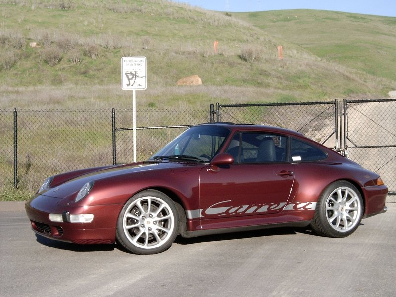

BTW The 996 18" SportDesign wheels are similar to the picture you show as they are a 10 spoke wheel. They come in a version with the offsets I gave above that will fit the 993 NB. I am sure you could find some to look at either from a local 996 owner with them or see some at a dealers.
