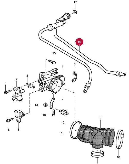

Difficult to see from the photo, but that could be the vacuum pipe which controls the heat exchanger for the Tiptronic cooler, and it DOES need to be connected to the throttle body.

Is it this pipe? If so, it is called the "venturi tube" (Tiptronics only) but I don't know what it does.
I thought you might mean the small (5mm-ish) pipe which provides vacuum to the cooler valve.
Hi Richard,
Yes that's the one.
found out the answer Here
So I think how I have it now is better than it was before and how I have seen others in the past with a breather filter on its end.
