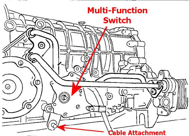

Richard - as ever your a goldmine of info and diagrams, do you have a diagram for this bit?

No, I don't mean the brake pedal switch. The MFS (multi-function switch) is on the side of the gearbox, connected by a cable to the gear selector in the car. If the switch or linkage are sticky you will feel it on the selector lever. If you could disconnect the cable at the MFS, it would tell you if the problem is in the selector or switch.
I'll see if I can find a diagram when I get to my PC tomorrow.
Not brilliant, but it will at least show you what you are looking for. It is mounted on the driver's side of the box.
