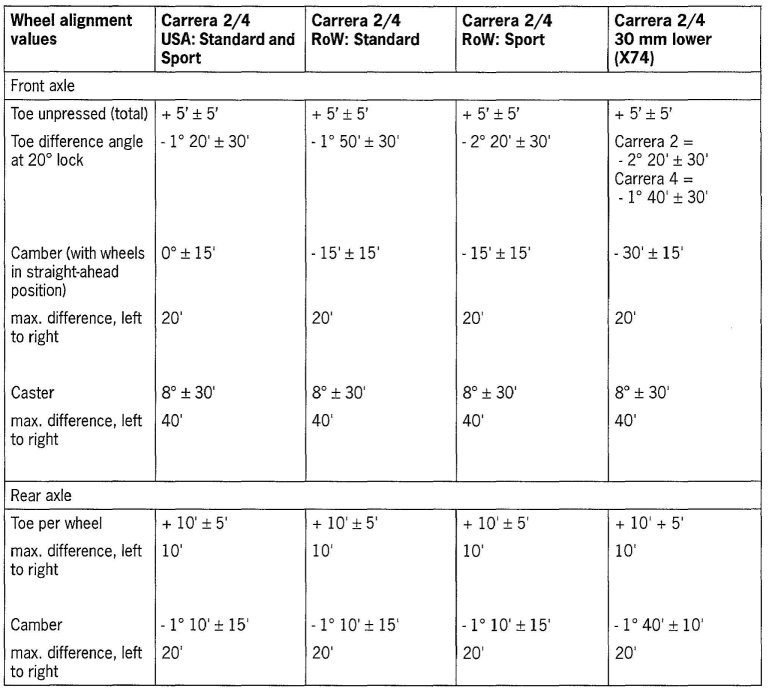

Does anyone know what the toe in setting is for the front wheels of the 996 (MY04). My tyres are wearing slightly more on the inside than the outside and need to get it checked out, I know it could possibly be other faults but I always check the easiest first. Any assistance would be appreciated.

The alignment settings are in the Members Only Technical Articles section, but here they are for the benefit of non-members:

Mine did the same, I took it as a good excuse for a full geometry check at GT1 in Chertsey.
The ones I have had in the pass have transformed the car.

Thanks for your answers, I will get the tracking checked out and will get my membership linked to the forum.
