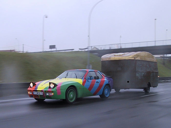

[;)] time for old caravan pic

ORIGINAL: berg944
Caravan!![:eek:]
Don't worry, it's only John and Belinda off to their beach hut in Southend [;)]
I'm glad Tony posted that because I was sure I had a copy of it but have searched my hard drive high and low and could find no trace [&:]
