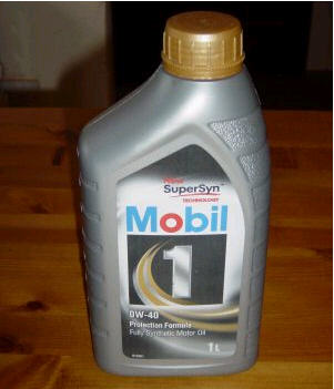

I think I have put in about 5L in 7000 miles.
You want Mobil 1 0W-40 (http://www.mobiloil.com/USA-English/MotorOil/Oils/Mobil_1_0W-40.aspx)
It's available Halfords or cheaper in bulk at http://www.oil-store.co.uk/?path=item&id=112

Well after almost 1L of Mobil 1's finest, my car is now topped up with 3 bars showing (but not over the top), so we'll see how that lasts.
Also bought a spare 1L bottle ready for when it needs topping up !!
