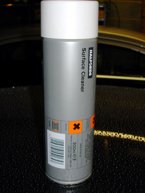

As an alternative to langka, try the Halfords Paint Cleaner - comes in a spray can for £3.99
touch in the chips / scratches, leave for a week. Then take a piece of soft cotton cloth, wrap tightly around a thin strip of plastic (like an old credit card) , soak the edge in paint cleaner and use the edge to smooth away the excess.

Yes Andrew - on 2 chips and no matter how careful i was with the touch up stick (and i mean cocktial stick here, not the touch up brush) there was some excess - the paint cleaner smoothed it off nicely.
ORIGINAL: Black80XSA
As an alternative to langka, try the Halfords Paint Cleaner - comes in a spray can for £3.99....
I tried 2 different branches of Halfords at the weekend and could not find this.
Can you confirm it is actually called this? (Before I make a fool of myself asking one of the staff, then having to try and explain what it is for, and being directed to the "chip-stick" display instead[;)])

Sorry guys - my receipt say paintwork cleaner, but the can says Surface Cleaner
