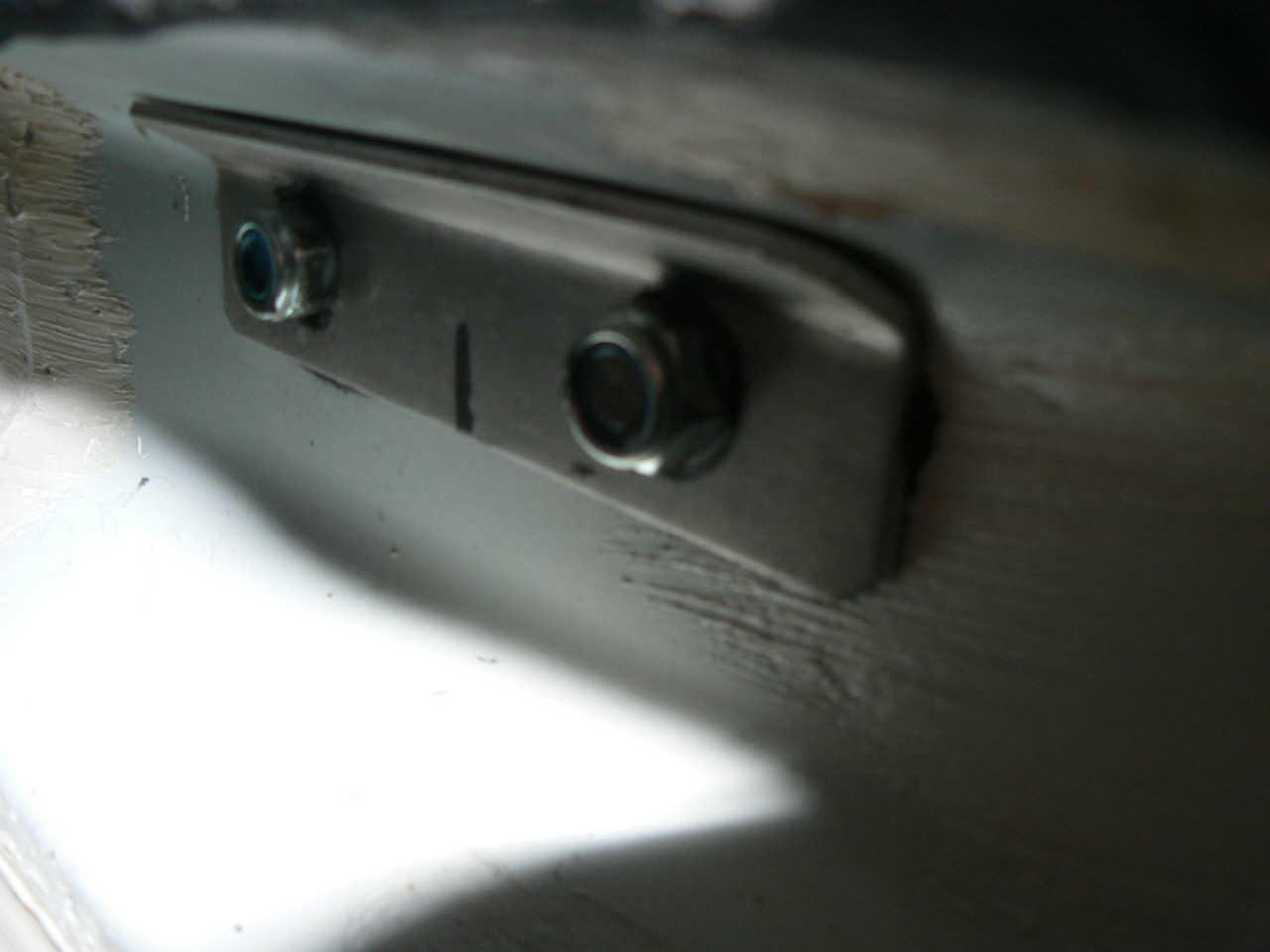

Hi Mel
Picture of the reinforcement plate would be great, this towing eye is similar but is smooth u shaped steel with threaded ends

Here's a picture of the back side of my special BLUE powder coated tow hook as fitted to my ex racer

Hi Lee
Thanks for that, I have adopted something similar to the back of mine.
Hi Rich
Yes, no problem, it comes with two 50mm square x 3mm thick washers/reinforcing plates. I installed them on mine and they will never pull through, even with the most heavy handed marshall.
