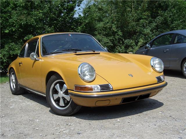

Anyway ,first attempt to post pics to a PCGB forum , not enough powers of concentration to embellish it with description but pictures tell a thousand words [:D]
well, u got to get the n/side door mirror off, thats 3 mph top speed! Lots of fun with it John we ll see u out in it soon i hope ..............................
You must have bought this off Patrick Dunster. Could you do me a favour, when you have the time, and send me your details and the chassis number so I can add you to the early 911 register. 911@porscheclubgb.com should get it to me. From the chassis number I can also give you the original details of the car.
