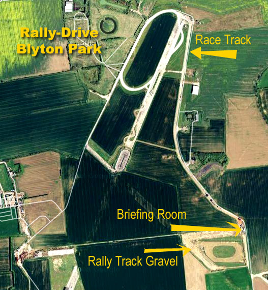

I didn't even know it existed until this week. It would appear to be an old air field of sorts, and is used by a company called 'Rallydrive' for rally car experiences. Therefore, the surface is not entirely perfect. Where there is tarmac it is generally pretty good, but every so often there are a number of quite pronounced 'crators' which unfortunately are pretty close to the driving line. Once you learnt to avoid them though, there was plenty of fun to be had! Attached is the best image I can find of the track, but really we were only using the bottom right hand side. A fairly short track and fairly low speed too (I was seeing 100ish on the straightest bits), but some nice opening corners. And the car was absoultely fantastic. When we got there I was behind a couple of old classics that weren't really up for the crack, but up front an R1-engined Caterfield and the D-type replica had taken off, so by the time the 2 cars in front finally pulled off (didn't think it would be very polite to pass them) the D-type was on my tail. Well I have waited a long time for this moment and when that thing was in my mirrors, I just floored it. It was putting out 380bhp, so kept up on the straights, but in the corners I just left him - even with him running 18inch XJR wheels and adjustable suspension. The '44 was a complete hoot to drive, really adjustable and balanced, and more than willing to indulge in some lovely oversteer. One of the slower corners was given me some trouble though - a 25mph right-hander in second. A long, swooping bend in a fairly tight radius, I just couldn't get the front end to bite. I got around it a little by trail braking into the bend which was a little faster, but without (really) another gear to drop down into, it made achieving a fast exit pretty challenging. I'm only running -1 degree on the front, so I assume adding a bit more camber may help. Any more suggestions?

What did you make of the track? It's a shame really as they have said you can book it out for the whole day with exclusive use for £400 mid-week! Anybody got any mates in road/drive laying?!
I do remember it being a bit rough around the edges. I did a day which consisted of several laps of the tarmac track with an instructor and the same around the gravel track in a MkII Golf GTi. That said I did go back on another day and drove my dad's very unforgiving Westfield round for half a day without much problem so it couldn't have been too bad. We paid £45 for the day and although there wasn't exclusive use there were never more than about 4 cars on there.
